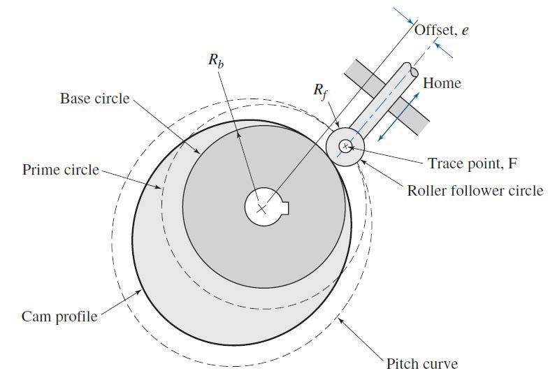

【20160405】Graphical Disk Cam Profile Design
% ~) ^% g/ w6 D" J7 f9 V2 S6 Q+ b; v& P7 m: B% x& J/ b& R. p
Cam nomenclature  凸轮设计相关术语5 Z& y! g2 C! }3 r8 m5 E* C
/ u- ]4 i' A/ ?3 vBase circle: the smallest circle centered on the cam rotation axis and tangent to the physical cam surface.) N4 ~5 k7 ?: B; J1 j
基圆:以凸轮转轴为中心的最小的圆,与物理表面相切。3 ?. Y9 k; d; d9 n: i
Trace point: severs as a reference to determine the effective location of the follower.
/ P/ F& Z8 i5 D追踪点:作为确定有效位置的参考点。
+ z. |. a& H" pPoint of cam and follower contact;Center of roller;Contact surface of follower……+ C+ S# {5 p5 H) h( T: Z8 E
凸轮与从动件接触点、滚轮中心、凸轮与平面接触点等均可作追踪点。, a5 x! l5 _) p. N$ w. y8 n
Home position :  the orientation that corresponds to the 0°reference position on a displacement diagram.- m& G7 f# T' g
初始位置:位移图上零度位置所对应的方向。% d* }% F1 }% z, W0 I6 ^+ ^, z
Pitch curve: the path of the center of the follower.
  Y: Z. ]' O) G/ O理论廓线:从动件中心的轨迹。% Q! e1 i3 i- m
Prime circle: the smallest circle which can be drawn tangent to the pitch curve; only applicable to cams with roller followers.5 b# L$ ^* ]: M' x( s( e0 X6 X' K
理论轮廓基圆:与理论廓线相切的最小圆;只用于滚轮从动件中。(其实就是roller中心绕基圆的运动轨迹嘛)
  `( H+ C% ~3 M: \  v* H3 k
3 W. x8 r( Y/ ^( m) {. Z  D2 h7 a9 r" M7 J. [9 D% |/ Q
Cams with roller followers are defined for manufacture with respect to the pitch curve rather than the cam's physical surface.+ R5 }" o7 O. s" L* H
滚轮从动件凸轮制造时主要依据理论廓线而不是凸轮的实际表面曲线。(二者差一个滚轮半径)7 A* i% i9 w  p7 i2 R* @; y
Cams with flat-faced followers must be defined for manufacture with respect to their physical surface, as there is no pitch curve.* _: @& y2 H! n0 V: o! ~
平面从动件制造时要依据物理表面,因为没有理论廓线。(面与凸轮的接触点时刻变化,没有确定追踪点)% o" A( _3 i9 [' L) q; {/ R

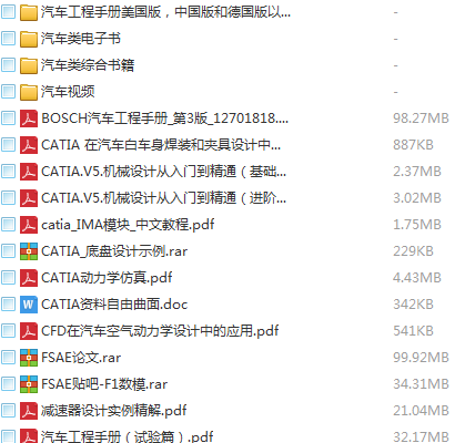

) l+ X; E) m; ~5 L* }- a% l 未命名图片.png 2 ]! o$ L* k5 W/ B. |
# k5 {1 v0 L" c: g1 ]但是这能做多久?做到什么程度?我现在也说不上来╮(╯▽╰)╭不过有一点是肯定的,这是件好事,做了肯定没坏处【除非还有比这更有好处、却被它占了时间的事】所以,趁年轻,just do it!

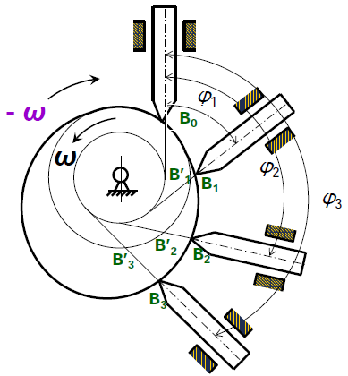

【20160406】Kinematic inversion# T- G- f8 k( @& X1 {
运动倒置
! X; [9 U5 E2 A% T( V: w* f7 Q/ D/ t1 _2 a
The cam will be imagined as being stationary.
2 R5 ?2 q- _! l* Z& N; @8 qThe follower then should be rotated opposite to the direction of cam rotation.( b! [+ @: u5 ~6 E
The desired location for the follower, at several positions, is constructed from the base circle.
( Q) r* l3 m, p) m; S. g: a" a, `. G假定凸轮不动,从动件沿相反方向转动,在基圆上画出从动件的几个预期运动位置。
: f; k, v! |3 f4 d

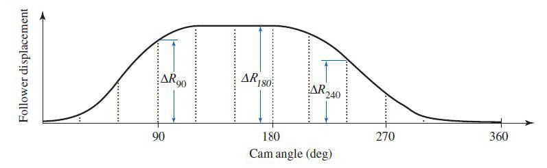

8 Y$ A8 g$ [9 D% f( j: J) [9 eTo creating the cam shape:  wrapping the displacement diagram around the base circle.
& c$ y) ]! J7 [% ?# P! C设计凸轮形状时,用从动件位移图上的位移将基圆“包裹”起来。
: P6 Q$ d1 J/ ~. o0 H# u6 p 未命名图片.png / U6 `* u! W0 k- }, C) g9 p

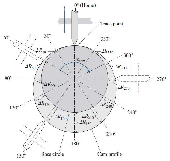

' M( H& u1 t! m' k6 e( V In-Line Knife-Edge Follower 对心直动尖顶从动件凸轮
) }0 E( J3 y% t3 J- k" `1. Draw the base circle of radius.
0 @! J% g. p. e/ `$ b# A% h" R2. Draw the follower in the home position.
; O8 V& D2 l, V0 q* h. w/ a% T3. Draw radial lines from the center of the cam, corresponding to the cam angles identified on the displacement diagram.
+ H7 x( X% U  W4. The follower will be rotated in a direction opposite to the actual cam rotation.; W, b  b/ O" _4 ?3 ?+ n
5. Transfer the displacements from the displacement diagram to the radial lines.
  b  I" d; P* b+ U9 ~5 _6. Measure the displacements from the base circle.# u( `; Z1 y' y. i$ z) F9 _) V: Q
* E2 R3 s5 }# _3 f- \
1.画出制定半径的基圆。
! C7 J# F, q2 h5 M3 @2.画出初始位置的从动件。- _3 \' F1 ?* u$ F$ b  t8 n
3.从中心画出基圆的径向线,角度与位移图上横轴凸轮角度相对应。
& F; A& z# J$ J' t4.从动件与凸轮真实运动方向相反。" @4 h$ ~+ ~2 ?, H) N
5.将位移移到径向线上。
" w% p: f% z0 \, g: I. e6.测量从动件远离凸轮基圆的距离。% A, K/ d& {1 V5 U
, y) A" V  D9 {' o

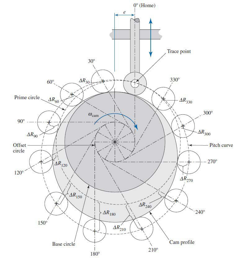

② Offset Roller Follower 偏置滚轮从动件  M( i1 @: B( h- [9 ~; I8 u9 }
Cha 07-2016.jpg Cha 07-2016.jpg , s, n9 O; c* L2 @
4 T, k% M; X- R# B2. Draw the follower centerline in the home position.
& R7 L  p+ ^+ _, I! V0 o3. Draw the prime circle.' h. J7 h/ a2 R. f; S% {: w
4. Draw the follower in the home position of radius.5 t; d( G4 h6 `$ D- l- K3 F
5. Draw an offset circle of radius, which will be tangent to the follower centerline.
7 ^) @4 u" Y) N9 r0 \6. Draw lines tangent to the offset circle, corresponding to the reference cam angles on the displacement diagram.) \3 k" X# H+ A
7. The follower will be rotated in a direction opposite to the actual cam rotation.
+ m4 P% e8 m7 Z: K. o; q1 m
' B' P. b4 z# q8 N$ v6 G1.画出制定半径的基圆。
. ^/ X# X: M5 r' f- e8 n. F2.画出初始位置的从动件中心线。
3 {6 Y, J$ k- g5 Q3.画出理论廓线。
, `( h* q7 N5 a2 ?) N4.画出初始位置的从动件。
$ H# ^7 m! I5 A# H5.以偏心距为半径画圆,与从动件中心线相切。
9 B5 d2 V3 I: n9 `' R5 }7 c% D! D6.与偏距圆相切画线,角度与位移图上横轴凸轮角度相对应。: p/ B0 U) v7 k! Y, y
7.从动件与凸轮真实运动方向相反。
  n- `% Q: Q+ L7 e! k" E
