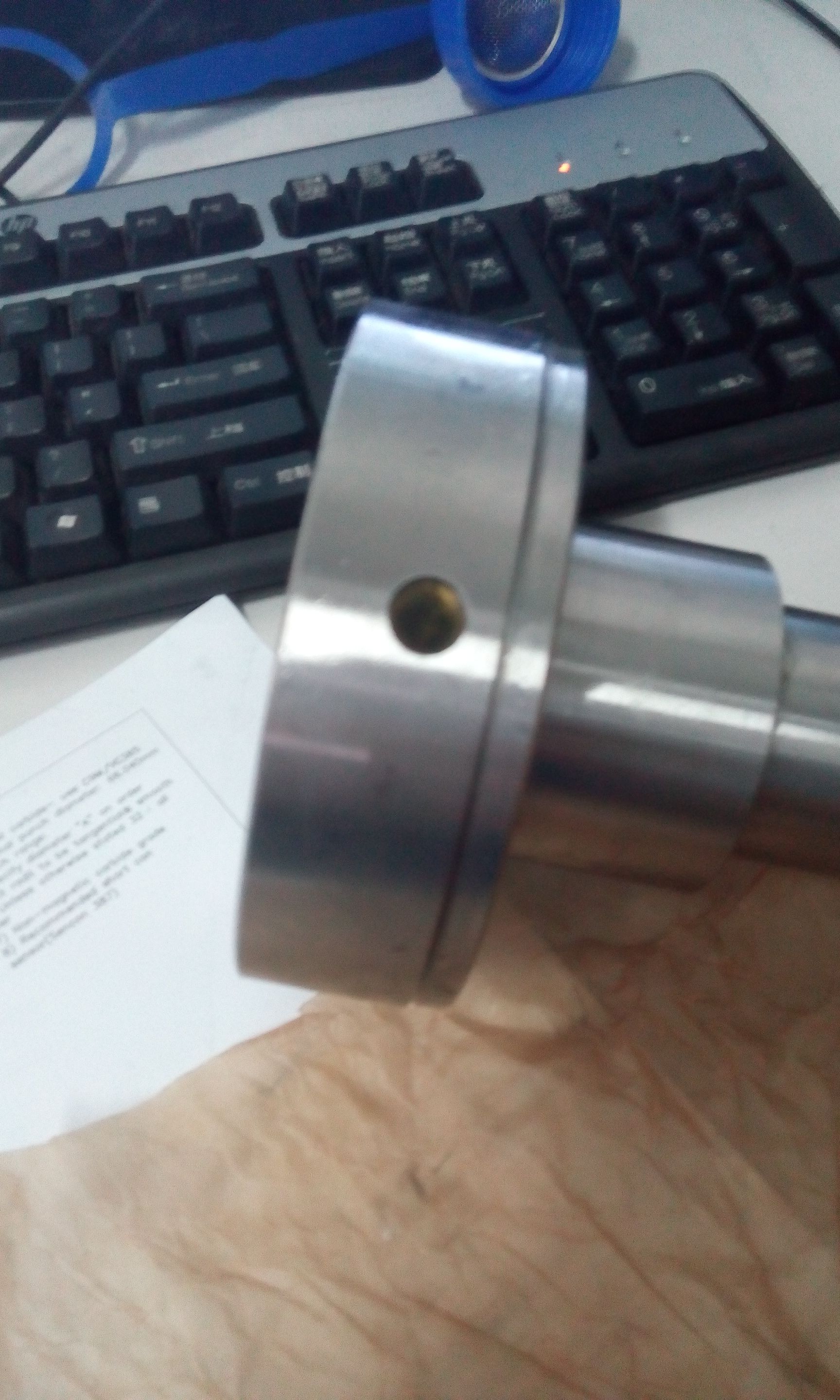

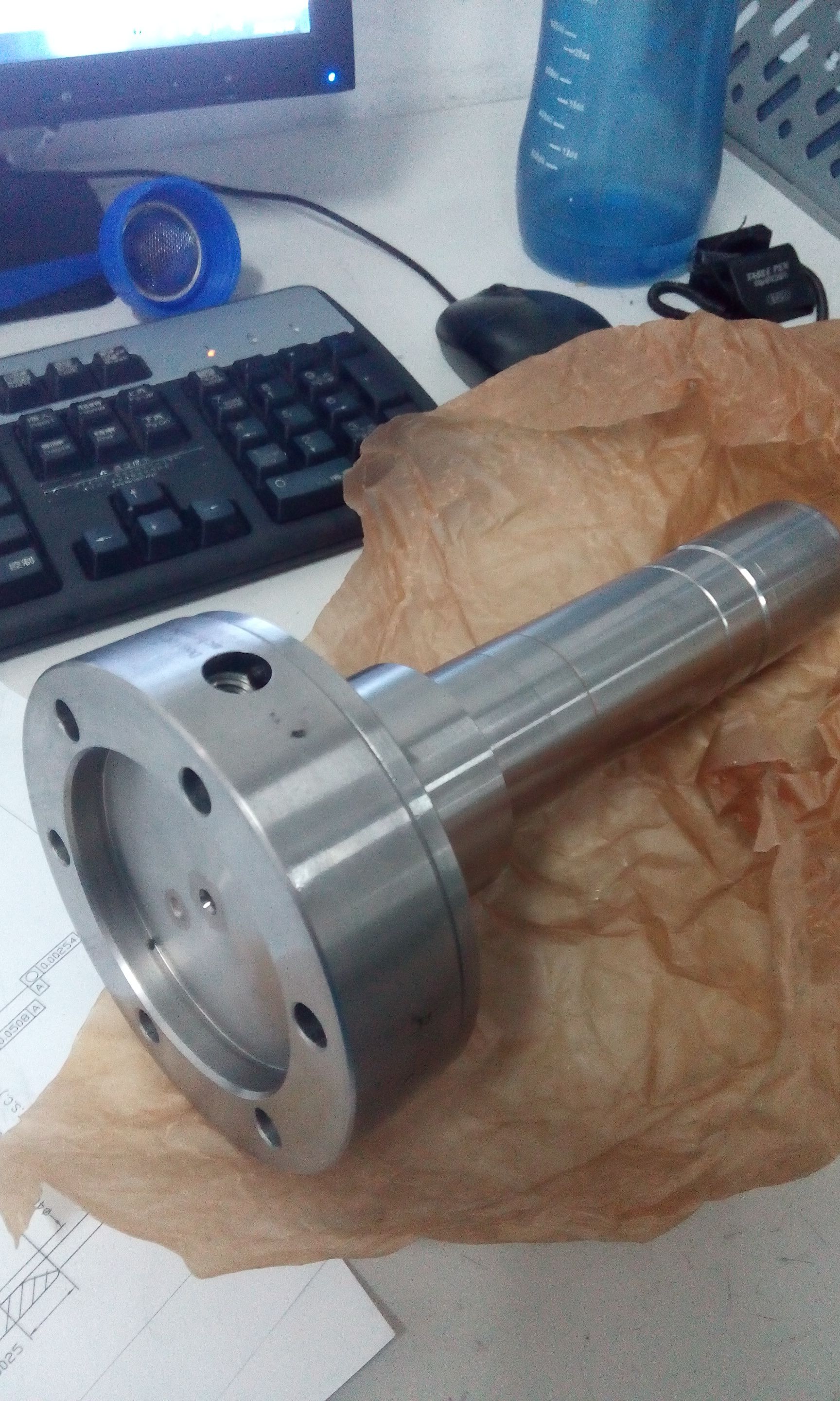

这种夹杆是否是静压膨胀工作原理?
; t1 a  i. Z9 r) S4 W+ {; `  g5 d胀紧夹杆的dosier孔能不能调节圆度。
! \% D/ M# u% e% b使夹杆顶部和底部同心都在0.002毫米以内。

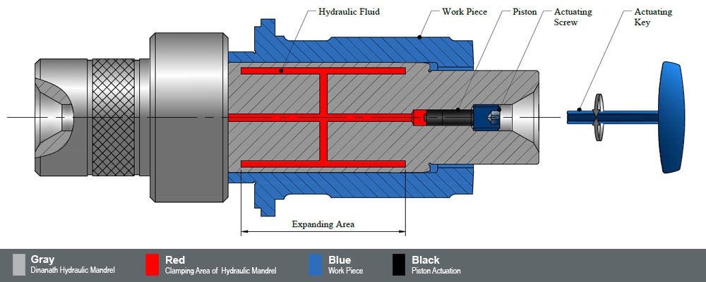

发表于 2015-8-18 15:04:53 | 显示全部楼层
Check this out

 楼主| 发表于 2015-8-18 18:35:24 | 显示全部楼层
joseph8779 发表于 2015-8-18 15:04 , Q2 t: ?2 w: f) X' l& \
Check this out
& T& J$ G: K: |4 k: I5 R* Q
工作原理清楚了。( S6 a. w" P0 }3 H4 i# q, ^7 Q
但那个孔的作用呢?是不是不能调?) ^+ k3 `' d! T8 p2 @! q
发表于 2015-8-19 07:47:13 | 显示全部楼层
Just like the piston in the hydraulic cylinder, turn the screw in, the pressure increases, if out, the pressure drops.: D+ V# O& I* C2 Y1 R
! T8 H8 n7 C: I  [
The hole is like hydraulic cylinder, adjusting the pressure should be through turning in/out the screw.

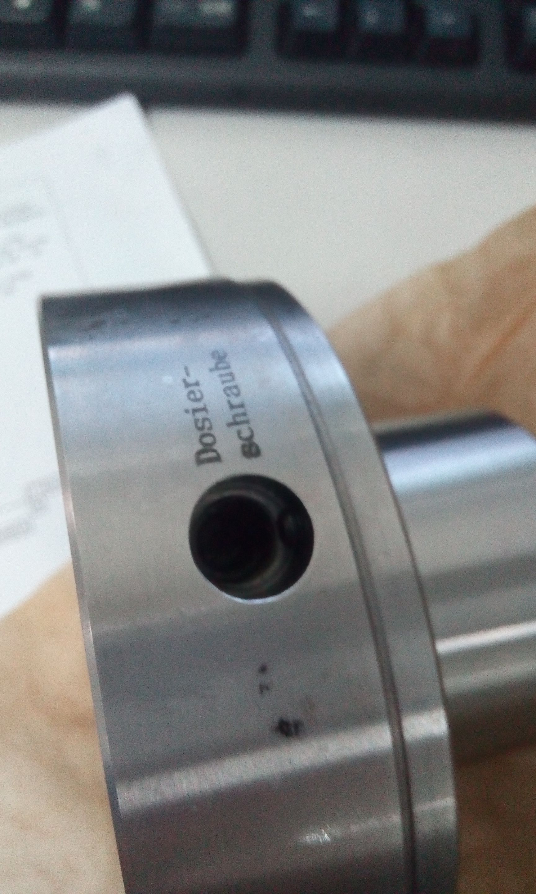

不,那是另外一个螺栓,在顶部。标有德文SPANN-SCHRAUBE.( ]3 r+ t- p2 F6 r% i; a4 ?
这个在底部。标为DOSIER-SCHRAUBE.
# a, Z, O! R3 n6 X这个DOSIER孔什么作用??

发表于 2015-8-19 15:15:54 | 显示全部楼层
Dosier is dosing in English, to control specified amount of oil input. My understanding is that there should be two holes on your fixture as you mentioned, and this dosing screw is only for filling oil. Also you can use this hole to drain out the oil, but at the same time you need to remove the  SPANN-SCHRAUBE, you can figure out why. Normally during production nobody touches the dosing screw. It doesn't help you on roundness.
