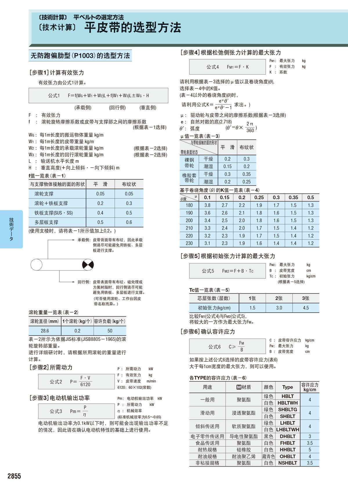

ΪʲôƽƤ´øµÄÓÐЧÕÅÁ¦»áÊܹõÂÖÖØÁ¿Ó°Ïì
[¸´ÖÆÁ´½Ó]
·¢±íÓÚ 2024-4-23 21:24:59 | ÏÔʾȫ²¿Â¥²ã |ÔĶÁģʽ
ÔÚmisimiÑ¡ÐÍÐÅÏ¢ÀïÃæ¿´µ½£¬¸ã²»µ½ÎªÊ²Ã´Æ½Æ¤´øµÄÓÐЧÕÅÁ¦»áÊܹõÂÖÖØÁ¿Ó°Ï죿ÓÐÎÞ´óÀнâÊÍ
»Ø¸´
ʹÓõÀ¾ß ¾Ù±¨
·¢±íÓÚ 2024-4-24 09:23:10 | ÏÔʾȫ²¿Â¥²ã
Æäʵ¾ÍÊÇ ¹öÂÖÖØÁ¿³ËÒÔĦ²ÁϵÊýµÈÓÚ¹öÂÖÐýתĦ²Á×èÁ¦¡£
 Â¥Ö÷| ·¢±íÓÚ 2024-4-24 09:26:04 | ÏÔʾȫ²¿Â¥²ã
chensqin ·¢±íÓÚ 2024-4-24 09:23
µ«¸Ð¾õºÜÆæ¹Ö£¬¹õÂÖûÓÐÖØÁ¦Ê©¼ÓÔÚƤ´øÉÏÃ棬ËãËüµÄĦ²ÁÁ¦²»Ó¦¸Ã¿´ËüµÄÖØÁ¦Ñ½
·¢±íÓÚ 2024-4-24 09:39:36 | ÏÔʾȫ²¿Â¥²ã
Õâô˵°É£¬¾ÍÊÇҪʹ¹öÂÖÐýת£¬¾ÍÒª¿Ë·þÕâ¸öĦ²Á×èÁ¦¡£Õâ¸ö×èÁ¦ÐèҪƤ´øÕÅÁ¦Æ½ºâËü¡£
·¢±íÓÚ 2024-4-24 09:40:35 | ÏÔʾȫ²¿Â¥²ã
chensqin ·¢±íÓÚ 2024-4-24 09:39
Õâ¸ö×èÁ¦À´×Ô¹öÂÖÖá³Ð
·¢±íÓÚ 2024-4-24 09:56:57 | ÏÔʾȫ²¿Â¥²ã
ÒòΪËüÓиö×ÔÖØ£¬Æ¤´øÔÚÕŽôʱҪ¿¼ÂÇ´ø¶¯Ëüת¶¯Ê±Ê©¼ÓÔÚËüÉÏÃæµÄÁ¦¾Ø£¨ËãÉϲÄÁϵÄĦ²ÁϵÊý£©
